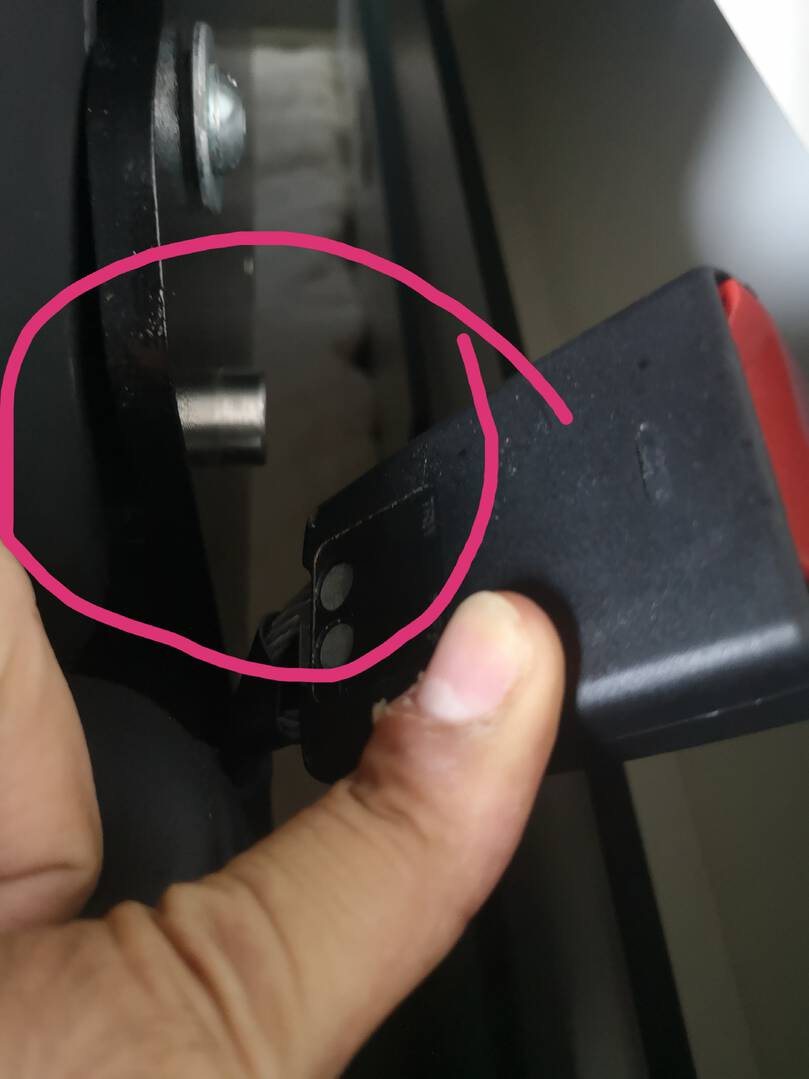

Ciao a tutti ho un problema. Tirando la maniglia rossa dello schienale del sedile posteriore lo stesso non si ribalta e non riesco a trasformare il sedile in letto. È capitato a qualcuno lo stesso problema?

Hi i will answer in English because i'm not able to understand Italian. A lot of our member has the same issue as you. Contact your Panama dealer to claim this problem as a warranty claim. As a workaround, you can try to push the bolts which fix the backrest with a tool like a screwdriver or so.

(@panama68)
Tanks Oliver, I tryed to press this button and pull the red strap  but it doesn't move
Hi @panama68,
I'm afraid we all have this problem sooner or later.. 🙁
This worked for me:
try to pull the red strap; This should at least "loosen" the bolt; then (when you still pull the red strap) press the bolt with your finger.
Hope this helps!
I do it in the same way. Be careful about your fingers.
